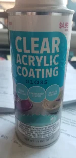

Shawn, what model? I've had very good luck with the generic acrylic gloss rattle cans from Hobby Lobby. They also have a Matte and Satin.

I've used this the past couple of years on my figures for a gloss.
Plaid Patricia Nimocks Clear Acrylic Sealer. Got it at Walmart. The matte version didn't dry all that flat though. It's more of a vinyl than a resin.
