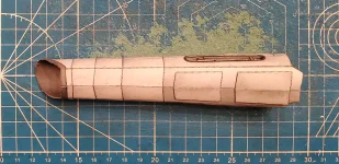

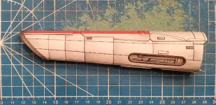

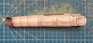

Starting with the fuselage. Here is the cardstock piece and the printer paper piece. When cutting the panels out, make certain that you are cutting away the "panel lines", so that the panels have no coloured edging from the lines.

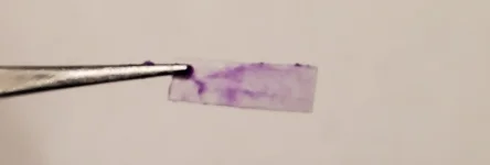

For laminating, I am using Elmer's "Purple" glue stick. (*NOTE* The glue does go on purple and dries clear.)
Here is the first piece with the purple glue.

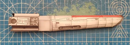

I have started applying the panels.
Once all of the panels have been applied, you can roll the fuselage and attach the recess panels.
I have sealed the fuselage ad applied the raised panels and greebling.

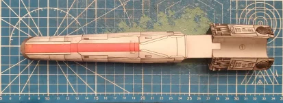

So, with my opening post for this thread, it illustrated the point of this thread and how to achieve the effect of "physical" panel lines in a model. I had initially thought about stopping there. However, since I had printed out the entire template of this model, I thought it best if I just continue the build. So, without further ado, here are the photos of my work thus far.
Here are the parts for the engine mounting block.
Unfortunately, I (inadvertently) deleted the photos showing the construction of the Engine mounting block. So, here is the completed engine mounting block. However, as you can see in the previous photo, there are extra "Y" shaped pieces (the back face of the engine mounting block). I used those extra pieces as internal formers/supports for the engine mounting block.
(*NOTE* If you decide that you want to do this, make certain that you cut the tabs off that help support the front face piece.)
I raised the details and greebling.
This is the connector between the fuselage and the engine mounting block.
I attached the connector to the fuselage.
I attached the engine mounting block to the connector.

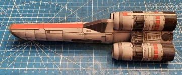

All three engines are complete.
The engines are attached in place.

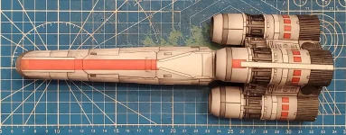

This build is OVER! :mad:🤬
I accidentally bumped the shelf that I had the Viper sitting on, knocking it off and stepping on it. So, this project is finished. :mad:🤬
With that being said, there is enough material to properly illustrate the technique of making panel lines.
